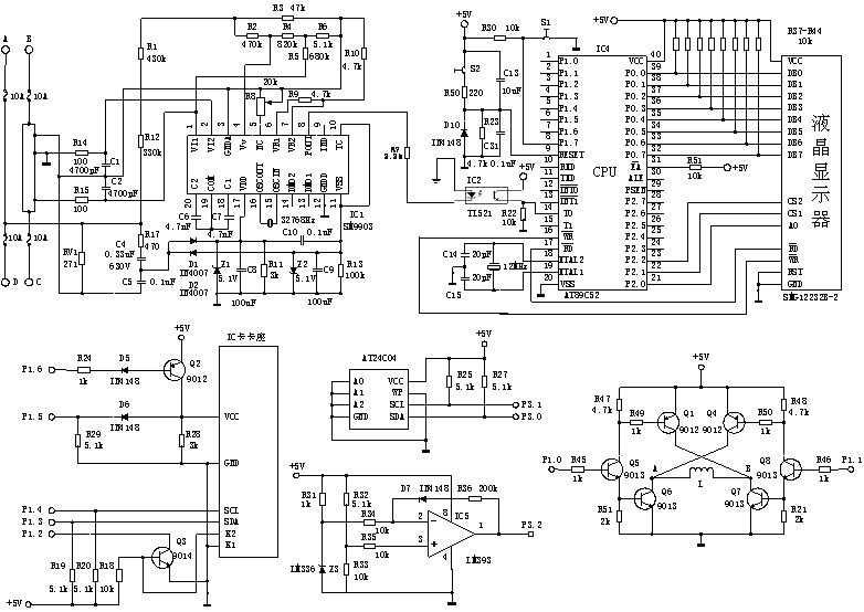

单相电子式预付费电度表的设计(电路+程序)

太极天驹 发表于 2008-10-6 9:16:56
;指示性语句--------------

              MOV    C,JWW
              POP    07H
              POP    06H
              POP    05H
              POP    04H
              POP    03H
              POP    02H
              POP    01H
              POP    00H
              POP    DPH
              POP    DPL
              POP    B
              POP    A
              RETI
;键盘复位程序
KEYRST:       SETB   S1
              MOV    KEYW,#01H
              MOV    SEER,#0FFH
              MOV    SEE,#00H
              RET
; 键扫描程序
KEY:          JB     S1,KEY4
              MOV    DEL,#26
              LCALL  DELY
              JB     S1,KEY4
              MOV    A,KEYW
              RL     A
              MOV    KEYW,A
              JNB    KEYW.03H,KEY1
              SETB   KEYW.00H
              CLR    KEYW.03H
KEY1:         JNB    KEYW.00H,KEY2
              MOV    SEE,#0
KEY2:         JNB    KEYW.01H,KEY3
              MOV    SEE,#1
KEY3:         JNB    KEYW.02H,KEY4
              MOV    SEE,#2
KEY4:         RET
DELY:         PUSH   DEL
DELY1:        PUSH   DEL
DELY2:        PUSH   DEL
DELY3:        DJNZ   DEL,DELY3
              POP    DEL
              DJNZ   DEL,DELY2
              POP    DEL
              DJNZ   DEL,DELY1
              POP    DEL
              DJNZ   DEL,DELY
              RET
; E2PROM复位程序
AT24RST:      MOV    SLA,#00H
              MOV    NUMBYT,#00H
              MOV    MTD,#00H
              MOV    MTD1,#00H
              MOV    MTD2,#00H
              MOV    MTD3,#00H
              MOV    MTD4,#00H
              MOV    MTD5,#00H
              MOV    MTD6,#00H
              MOV    MTD7,#00H
              MOV    MTD8,#00H
              MOV    MRD,#00H
              MOV    MRD1,#00H
            MOV    MRD2,#00H
              MOV    MRD3,#00H
              MOV    MRD4,#00H
              MOV    MRD5,#00H
              MOV    MRD6,#00H
              MOV    MRD7,#00H
              MOV    MRD8,#00H
              RET
WRNBYT:       NOP
              NOP
              LCALL  STA
              NOP
              NOP
              MOV    A,SLA
              NOP
              NOP
              LCALL  WRB
              NOP
              NOP
              LCALL  CACK
              NOP
              NOP
              JB     F0,WRNBYT
              MOV    R0,#MTD
              MOV    R5,NUMBYT
WRDA:         MOV    A,@R0
              LCALL  WRB
              NOP
              NOP
              LCALL  CACK
              NOP
              NOP
              JB     F0,WRNBYT
              INC    R0
              DJNZ   R5,WRDA
              LCALL  STOP
              RET
RDNBYT:       NOP
              NOP
              LCALL  STA
              NOP
              NOP
              MOV    A,SLA
              LCALL  WRB
              NOP
              NOP
              LCALL  CACK
              NOP
              NOP
              JB     F0,RDNBYT
              MOV    A,MRD
              NOP
              NOP
              LCALL  WRB
              NOP
              NOP
              LCALL  CACK
              NOP
              NOP
              JB     F0,RDNBYT
              NOP
              NOP
              LCALL  STA
              MOV    A,SLA
              SETB   ACC.0
              LCALL  WRB
              NOP
              NOP
              LCALL  CACK
              NOP
              NOP
              JB     F0,RDNBYT
              MOV    R1,#MRD1
GO_ON:        LCALL  RDB
              MOV    @R1,A
              DJNZ   NUMBYT,ACK
              LCALL  MNACK
              NOP
              NOP
              LCALL  STOP
              RET
ACK:          LCALL  MACK
              INC    R1
              AJMP   GO_ON
STA:          SETB   SDA
              SETB   SCL
              NOP
              NOP
              NOP
              NOP
              NOP
              CLR    SDA
              NOP
              NOP
              NOP
              NOP
              NOP
              CLR    SCL
              RET
STOP:         CLR    SDA
              SETB   SCL
              NOP
              NOP
              NOP
              NOP
              NOP
              SETB   SDA
              NOP
              NOP
              NOP
              NOP
              NOP
              CLR    SDA
              RET
WRB:          MOV    R7,#8
WLP:          RLC    A
              JC     WR1
              CLR    SDA
              SETB   SCL
              NOP
              NOP
              NOP
              NOP
              NOP
              CLR    SCL
              DJNZ   R7,WLP
              RET
WR1:          SETB   SDA
              SETB   SCL
              NOP
              NOP
              NOP
              NOP
              NOP
              CLR    SCL
              CLR    SDA
              DJNZ   R7,WLP
              RET
CACK:         SETB   SDA
              SETB   SCL
              NOP
              NOP
              NOP
              MOV    C,SDA
              MOV    F0,C
              CLR    SCL
              NOP
              NOP
              NOP
              RET
RDB:          MOV    R7,#8
RLP:          SETB   SDA
              SETB   SCL
              MOV    C,SDA
              MOV    A,R6
              RLC    A
              MOV    R6,A
              CLR    SCL
              DJNZ   R7,RLP
              RET
MACK:         CLR    SDA
              SETB   SCL
              NOP
              NOP
              NOP
              NOP
              NOP
              CLR    SCL
              SETB   SDA
              RET
MNACK:        SETB   SDA
              SETB   SCL
              NOP
              NOP
              NOP
              NOP
              NOP
              CLR    SCL
              CLR    SDA
            RET
; IC卡复位程序
AT24RSTI:     MOV    SLA,#00H
              MOV    NUMBYT,#00H
              MOV    MTDI,#00H
              MOV    MTD1I,#00H
              MOV    MTD2I,#00H
              MOV    MTD3I,#00H
              MOV    MTD4I,#00H
              MOV    MTD5I,#00H
              MOV    MTD6I,#00H
              MOV    MTD7I,#00H
              MOV    MTD8I,#00H
              MOV    MRDI,#00H
              MOV    MRD1I,#00H
              MOV    MRD2I,#00H
              MOV    MRD3I,#00H
              MOV    MRD4I,#00H
              MOV    MRD5I,#00H
              MOV    MRD6I,#00H
              MOV    MRD7I,#00H
              MOV    MRD8I,#00H
              RET
WRNBYTI:      NOP
              NOP
              LCALL  STAI
              NOP
              NOP
              MOV    A,SLA
              NOP
              NOP
              LCALL  WRBI
              NOP
              NOP
              LCALL  CACKI
              NOP
              NOP
              JB     F0,WRNBYTI
              MOV    R0,#MTDI
              MOV    R5,NUMBYT
WRDAI:        MOV    A,@R0
              LCALL  WRBI
              NOP
              NOP
              LCALL  CACKI
              NOP
              NOP
              JB     F0,WRNBYTI
              INC    R0
              DJNZ   R5,WRDAI
              LCALL  STOPI
              RET
RDNBYTI:      MOV    RE,#200
RDNBYTI1:     DJNZ   RE,RDNBYTI2
              MOV    SEERR,SEE
              MOV    SEE,#6
              MOV    SEER,SEE
              MOV    TH1,#00H
              MOV    TL1,#00H
              MOV    COL,#100
              SETB   EA
              SETB   ET1
              SETB   TR1
              RET
RDNBYTI2:     NOP
              NOP
              LCALL  STAI
              NOP
              NOP
              MOV    A,SLA
              LCALL  WRBI
              NOP
              NOP
              LCALL  CACKI
              NOP
              NOP
              JB     F0,RDNBYTI1
              MOV    A,MRDI
              NOP
              NOP
              LCALL  WRBI
              NOP
              NOP
              LCALL  CACKI
              NOP
              NOP
              JB     F0,RDNBYTI1
              NOP
              NOP
              LCALL  STAI
              MOV    A,SLA
              SETB   ACC.0
              LCALL  WRBI
              NOP
              NOP
              LCALL  CACKI
              NOP
              NOP
              JB     F0,RDNBYTI1
              MOV    R1,#MRD1I
GO_ONI:       LCALL  RDBI
              MOV    @R1,A
              DJNZ   NUMBYT,ACKI
              LCALL  MNACKI
              NOP
              NOP
              LCALL  STOPI
              RET
ACKI:         LCALL  MACKI
              INC    R1
              AJMP   GO_ONI
STAI:         SETB   SDAI
              SETB   SCLI
              NOP
              NOP
              NOP
              NOP
              NOP
              CLR    SDAI
              NOP
              NOP
              NOP
              NOP
              NOP
              CLR    SCLI
              RET
STOPI:        CLR    SDAI
              SETB   SCLI
              NOP
              NOP
              NOP
              NOP
              NOP
              SETB   SDAI
              NOP
              NOP
              NOP
              NOP
              NOP
              CLR    SDAI
              RET
WRBI:         MOV    R7,#8
WLPI:         RLC    A
              JC     WR1I
              CLR    SDAI
              SETB   SCLI
              NOP
              NOP
              NOP
              NOP
              NOP
              CLR    SCLI
              DJNZ   R7,WLPI
              RET
WR1I:         SETB   SDAI
              SETB   SCLI
              NOP
              NOP
              NOP
              NOP
              NOP
              CLR    SCLI
              CLR    SDAI
              DJNZ   R7,WLPI
              RET
CACKI:        SETB   SDAI
              SETB   SCLI
              NOP
              NOP
              NOP
              MOV    C,SDAI
              MOV    F0,C
              CLR    SCLI
              NOP
              NOP
              NOP
              RET
RDBI:         MOV    R7,#8
RLPI:         SETB   SDAI
              SETB   SCLI
              MOV    C,SDAI
              MOV    A,R6
              RLC    A
              MOV    R6,A
              CLR    SCLI
              DJNZ   R7,RLPI
              RET
MACKI:        CLR    SDAI
              SETB   SCLI
              NOP
              NOP
              NOP
              NOP
              NOP
              CLR    SCLI
              SETB   SDAI
              RET
MNACKI:       SETB   SDAI
              SETB   SCLI
              NOP
              NOP
              NOP
              NOP
              NOP
              CLR    SCLI
              CLR    SDAI
              RET
;显示复位程序----------------
DIRRST:       CLR    A
              MOV    SEE09,A
              MOV    SEE08,A
              MOV    SEE07,A
              MOV    SEE06,A
              MOV    SEE05,A
              MOV    SEE04,A
              MOV    SEE03,A
              MOV    SEE02,A
              MOV    SEE01,A
              MOV    SEE00,A
              MOV    SEE17,A
              MOV    SEE16,A
              MOV    SEE15,A
              MOV    SEE14,A
              MOV    SEE13,A
              MOV    SEE12,A
              MOV    SEE11,A
              MOV    SEE10,A
              LCALL  LCDRESET                 ;执行液晶显示器复位程序
              MOV    A,#00H
              LCALL  LCDFILL
              RET
;显示程序
DIR:          MOV    A,SEE
              MOV    B,#2
              MUL    AB
              ADD    A,SEE
              MOV    DPTR,#DIRR
              JMP    @A+DPTR
DIRR:         LJMP   DIR0
              LJMP   DIR1
              LJMP   DIR2
              LJMP   DIR3
              LJMP   DIR4
              LJMP   DIR5
              LJMP   DIR6
              LJMP   DIR7
              LJMP   DIR8
              LJMP   DIR9
              LJMP   DIR10
              LJMP   DIR11
              LJMP   DIR12
              LJMP   DIR13
DIR0:         MOV    DPTR,#STRING3
              MOV    XPOS,#20
              MOV    YPOS,#00H
              MOV    R1,#5
              LCALL  PUTSTR
              MOV    DPTR,#STRING6
              MOV    XPOS,#12
              MOV    YPOS,#02H
              MOV    R1,#7
              LCALL  PUTSTR
              RET
DIR1:         MOV    DPTR,#STRING4
              MOV    XPOS,#00H
              MOV    YPOS,#00H
              MOV    R1,#5
              LCALL  PUTSTR
              MOV    XPOS,#8
              MOV    YPOS,#02H
              MOV    R0,#SEE09
              MOV    RE,#7
DIRR11:       MOV    A,@R0
              MOV    B,#2
              MUL    AB
              MOV    DPTR,#STRING1
              CLR    C
              ADD    A,DPL
              MOV    DPL,A
              CLR    A
              ADDC   A,DPH
              MOV    DPH,A
              MOV    R1,#1
              LCALL  PUTSTR
              INC    R0
              DJNZ   RE,DIRR11
              MOV    DPTR,#STRING23
              MOV    R1,#1
              LCALL  PUTSTR
              MOV    R0,#SEE02
              MOV    RE,#3
DIRR12:       MOV    A,@R0
              MOV    B,#2
              MUL    AB
              MOV    DPTR,#STRING1
              CLR    C
              ADD    A,DPL
              MOV    DPL,A
              CLR    A
              ADDC   A,DPH
              MOV    DPH,A
              MOV    R1,#1
              LCALL  PUTSTR
              INC    R0
              DJNZ   RE,DIRR12
              MOV    DPTR,#STRING2
              MOV    R1,#3
              LCALL  PUTSTR
              RET
DIR2:         MOV    DPTR,#STRING5
              MOV    XPOS,#00H
              MOV    YPOS,#00H
              MOV    R1,#5
              LCALL  PUTSTR
              MOV    XPOS,#24
              MOV    YPOS,#02H
              MOV    R0,#SEE17
              MOV    RE,#5
DIRR21:       MOV    A,@R0
              MOV    B,#2
              MUL    AB
              MOV    DPTR,#STRING1
              CLR    C
              ADD    A,DPL
              MOV    DPL,A
              CLR    A
              ADDC   A,DPH
              MOV    DPH,A
              MOV    R1,#1
              LCALL  PUTSTR
              INC    R0
              DJNZ   RE,DIRR21
              MOV    DPTR,#STRING23
              MOV    R1,#1
              LCALL  PUTSTR
              MOV    R0,#SEE12
              MOV    RE,#3
DIRR22:       MOV    A,@R0
              MOV    B,#2
              MUL    AB
              MOV    DPTR,#STRING1
              CLR    C
              ADD    A,DPL
              MOV    DPL,A
              CLR    A
              ADDC   A,DPH
              MOV    DPH,A
              MOV    R1,#1
              LCALL  PUTSTR
              INC    R0
              DJNZ   RE,DIRR22
              MOV    DPTR,#STRING2
              MOV    R1,#3
              LCALL  PUTSTR
              RET
DIR3:         MOV    DPTR,#STRING7
              MOV    XPOS,#32
              MOV    YPOS,#00H
              MOV    R1,#3
              LCALL  PUTSTR
              MOV    DPTR,#STRING8
              MOV    XPOS,#00H
              MOV    YPOS,#02H
              MOV    R1,#7
              LCALL  PUTSTR
              RET
DIR4:         MOV    DPTR,#STRING9
              MOV    XPOS,#24
              MOV    YPOS,#00H
              MOV    R1,#4
              LCALL  PUTSTR
              MOV    DPTR,#STRING10
              MOV    XPOS,#24
              MOV    YPOS,#02H
              MOV    R1,#5
              LCALL  PUTSTR
              RET
DIR5:         MOV    DPTR,#STRING11
              MOV    XPOS,#32
              MOV    YPOS,#00H
              MOV    R1,#3
              LCALL  PUTSTR
              MOV    DPTR,#STRING12
              MOV    XPOS,#24
              MOV    YPOS,#02H
              MOV    R1,#4
              LCALL  PUTSTR
              RET
DIR6:         MOV    DPTR,#STRING13
              MOV    XPOS,#32
              MOV    YPOS,#00H
              MOV    R1,#3
              LCALL  PUTSTR
              MOV    DPTR,#STRING10
              MOV    XPOS,#24
              MOV    YPOS,#02H
              MOV    R1,#5
              LCALL  PUTSTR
              RET
DIR7:         MOV    DPTR,#STRING14
              MOV    XPOS,#32
              MOV    YPOS,#00H
              MOV    R1,#4
              LCALL  PUTSTR
              MOV    DPTR,#STRING15
              MOV    XPOS,#16
              MOV    YPOS,#02H
              MOV    R1,#5
              LCALL  PUTSTR
              RET
DIR8:         MOV    DPTR,#STRING16
              MOV    XPOS,#32
              MOV    YPOS,#00H
              MOV    R1,#3
              LCALL  PUTSTR
              MOV    DPTR,#STRING21
              MOV    XPOS,#00H
              MOV    YPOS,#2
              MOV    R1,#8
              LCALL  PUTSTR
              RET
DIR9:         MOV    DPTR,#STRING17
              MOV    XPOS,#32
              MOV    YPOS,#00H
              MOV    R1,#3
              LCALL  PUTSTR
              MOV    DPTR,#STRING18
              MOV    XPOS,#16
              MOV    YPOS,#02H
              MOV    R1,#5
              LCALL  PUTSTR
              RET
DIR10:        MOV    DPTR,#STRING19
              MOV    XPOS,#24
              MOV    YPOS,#00H
              MOV    R1,#4
              LCALL  PUTSTR
              MOV    DPTR,#STRING10
              MOV    XPOS,#24
              MOV    YPOS,#02H
              MOV    R1,#5
              LCALL  PUTSTR
              RET
DIR11:        MOV    DPTR,#STRING20
              MOV    XPOS,#32
              MOV    YPOS,#00H
              MOV    R1,#4
              LCALL  PUTSTR
              RET
DIR12:        MOV    DPTR,#STRING22
              MOV    XPOS,#32
              MOV    YPOS,#1
              MOV    R1,#3
              LCALL  PUTSTR
              RET
DIR13:        MOV    DPTR,#STRING18
              MOV    XPOS,#24
              MOV    YPOS,#1
              MOV    R1,#5
              LCALL  PUTSTR
              RET
DELAY400MS:   MOV    R0,#20          ;延时子程序(400MS)
DL4_PA:       MOV    R1,#100
DL4_PB:       MOV    R2,#100
              DJNZ   R2,$
              DJNZ   R1,DL4_PB
              DJNZ   R0,DL4_PA
              RET
DELAY:        MOV    R6,#2
DLY_PA:       MOV    R5,#2H
DLY_PB:       MOV    R4,#2H
              DJNZ   R4,$
              DJNZ   R5,DLY_PB
              DJNZ   R6,DLY_PA
              RET
GETSTRCHAR:
GSC_PA:       CLR    A
              MOVC   A,@A+DPTR
              INC    DPTR
              MOV    B,A
              INC    A
              CLR    C
              JZ     GSC_LAX
              CLR    A
              MOVC   A,@A+DPTR
              INC    DPTR
              SETB   C
GSC_LAX:      RET
PUTSTR:       LCALL  DELAY
              LCALL  GETSTRCHAR
              PUSH   DPL
              PUSH   DPH
              JNC    PSR_LAX
              JNB    B.7,PSR_LBY
              LCALL  HZKPOS
              LCALL  PUTCHARDOT
              LCALL  PUTCHARDOT
              LJMP   PSR_LBX
PSR_LBY:      LCALL  HZKPOS
              LCALL  PUTCHARDOT
PSR_LBX:      POP    DPH
              POP    DPL
              DJNZ R1,PUTSTR
              RET
SR_LAX:       POP    DPH
              POP    DPL
              RET
PUTCHARDOT:   MOV    R7,#8
PAC_PA:       CLR    A
              MOVC   A,@A+DPTR
              LCALL  LCDWRITE
              INC    YPOS
              INC    DPTR
              CLR    A
              MOVC   A,@A+DPTR
              LCALL  LCDWRITE
              DEC    YPOS
              INC    DPTR
              LCALL  CUSORNEXT
              MOV    A,XPOS
              JNZ    PAC_LAX
              INC    YPOS
PAC_LAX:      DJNZ   R7,PAC_PA
              RET
HZKPOS:       MOV    R2,#5
HTP_PA:       CLR    C
              RLC    A
              XCH    A,B
              RLC    A
              XCH    A,B
           DJNZ   R2,HTP_PA
              MOV    DPTR,#HZKDOT
           ADD    A,DPL
           MOV    DPL,A
           MOV    A,B
           ADDC   A,DPH
           MOV    DPH,A
           RET
LCDFILL:      MOV    R7,A           ;LCD整屏显示A的内容
              MOV    YPOS,#0
LFL_PB:       MOV    XPOS,#0
LFL_PA:       MOV    A,R7
              LCALL  LCDWRITE       ;定位并写数据
              LCALL  CUSORNEXT
              MOV    A,XPOS
              JNZ    LFL_PA
              MOV    A,YPOS
              JNZ    LFL_PB
              RET
LCDWRITE:     LCALL  LCDPOS       ;定位并写数据子程序,内部写数指针定位
              LCALL  LCDWD        ;写数据
              RET
CUSORNEXT:    INC    XPOS
              MOV    A,XPOS
              CJNE   A,#128,CNT_LAX
           MOV    XPOS,#0
           INC    YPOS
           ANL    YPOS,#3H
